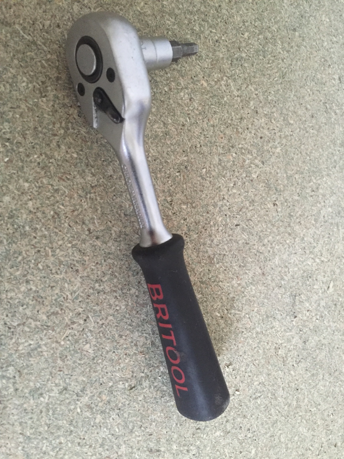

The bolt is quick and easy with this (small 1/4" ratchet with a 4mm Allen key):
Sent from my iPhone 
Just to add you have to lie on the floor and hook your arm/wrist around the exhaust but once you get the hang of it it's quick and easy.
