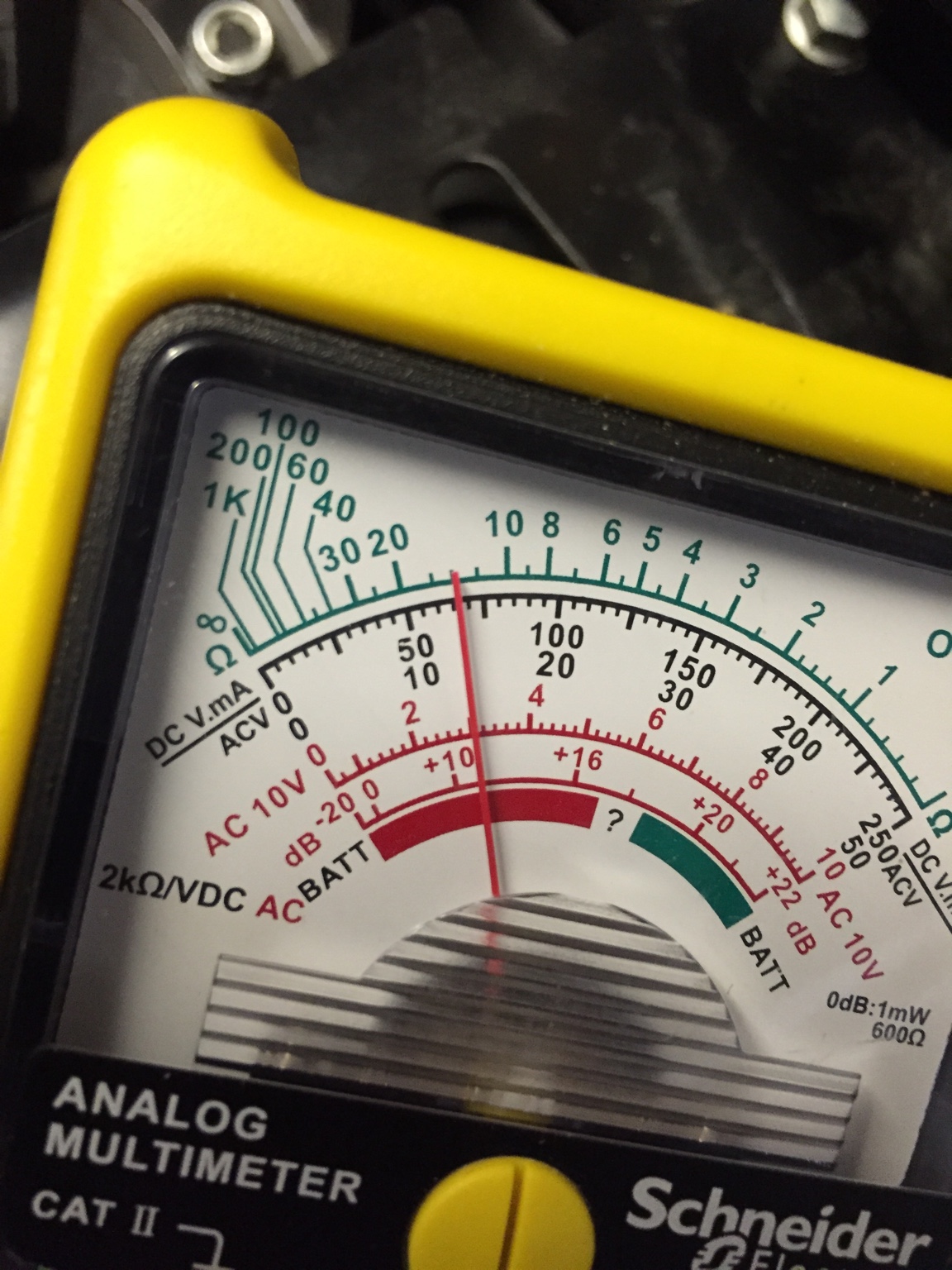

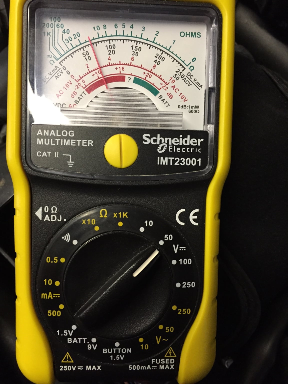

Here's what my battery currently looks like with the key out of the ignition, do I even have the meter on the right setting? I think I have it set to DC 50v and that its reading about 11v?

Got my digital one out, battery measures 12.7v with the ignition off.
Not sure if I'm doing this next bit right but with the multimeter in series between the negative terminal on the battery and the bikes negative lead it reads 12.3v (does that mean my bike is constantly draining 12.3v?)

OK it seems I need to have the multimeter set to Amps in order to check for a battery drain. So I've done this (with my digital meter, not the meter above in the photos as I don't think that one does Amps) and connected it in series between the bike and the negative battery terminal. And got a reading of zero, I then switched the multimeter down to 200mA and still got a reading of zero so surely this means there is no drain? I'm a bit dubious of a reading of zero as surely there should be some small drain for the dash memory?

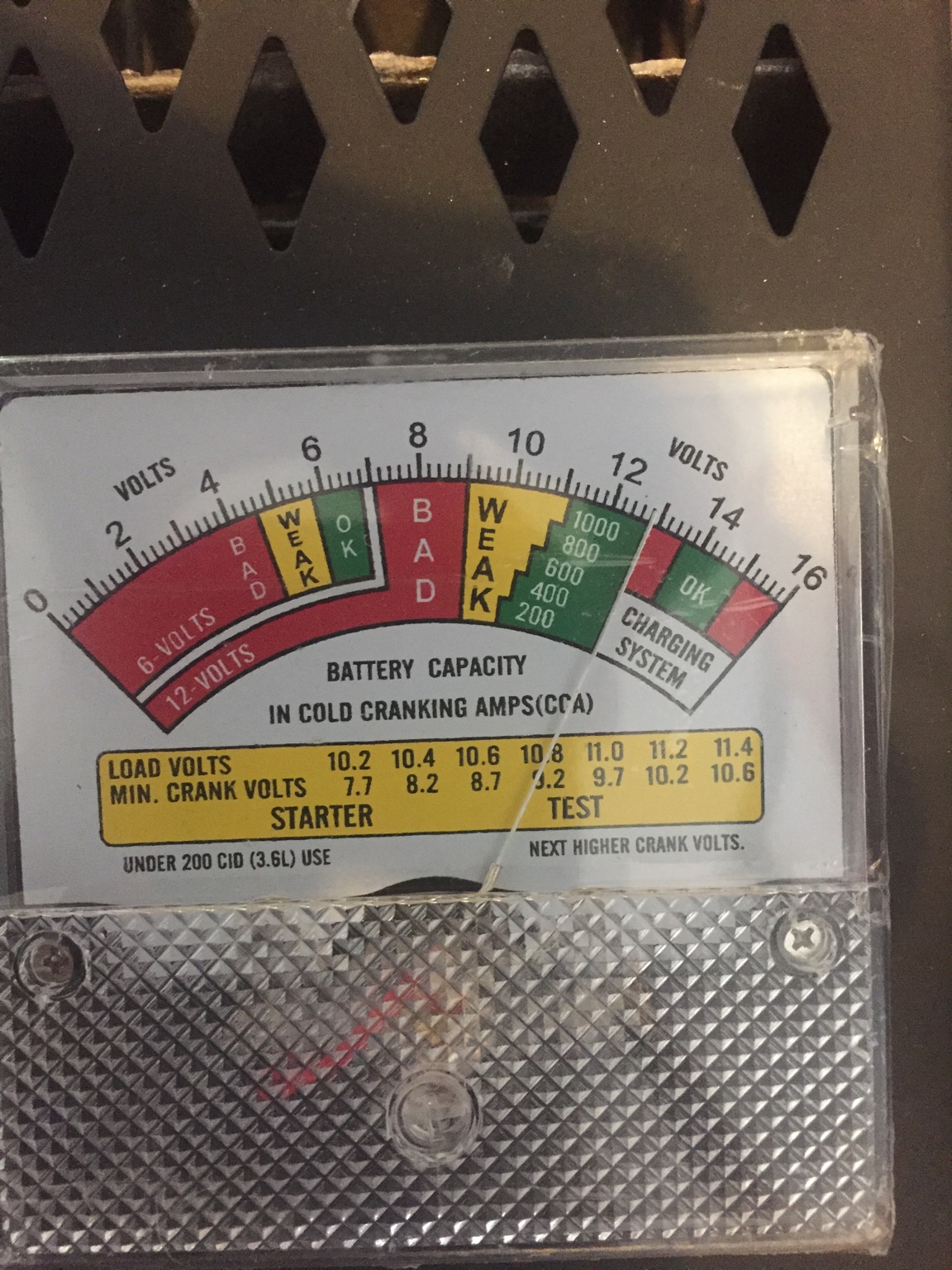

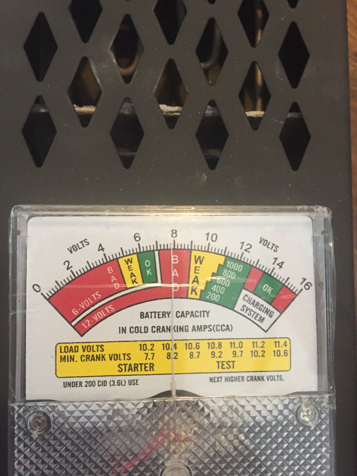

Battery tester arrived and I'm pretty sure my battery is fucked.
Charged battery for at least 24hrs, results:
No load (12.8v)
Load applied, needle started just inside the WEAK section and quickly moved to BAD:
With the load off again the needle quickly went back to 12.8v so according to the instructions that indicates a knackered battery:
