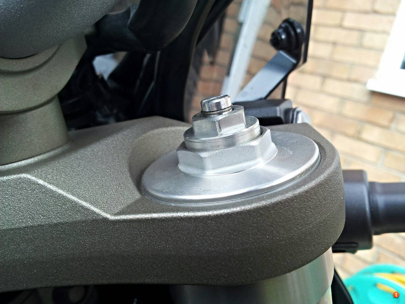

Do you mean like this? Or up to the very last ring?
