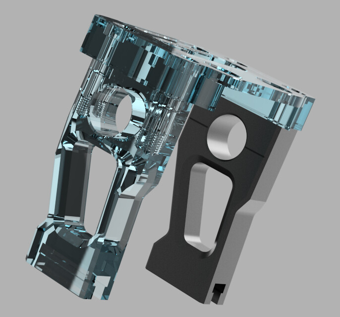

So, not sure if anyone has seen my thread in the main MT09 / Custom forums?
It started with me asking what parts people might be interested in and I was asked to look at something like the Yahama bar risers that are fairly pricy (£200 for a set).

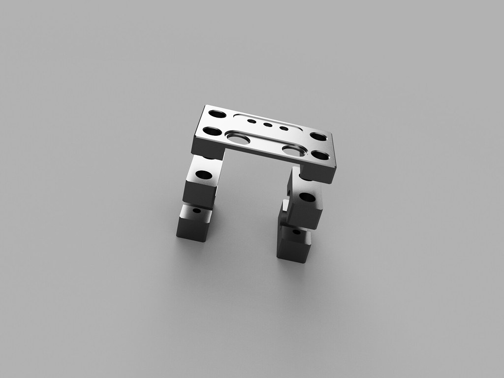

So long story short, came up with a 3 part riser system which includes an optional plate that can be used for mounting custom stuff.
I own an MT09 and dont have access to a Tracer. Id be willing to provide someone with these parts for 50% cost if they are able to help me with accurate measurements or either bring the bike to me to measure up.
Also, can people let me know what they think is a fair cost for these, please be realistic. There is a lot of work and investment in machines / tooling needed. I have an idea but would like for some verification before I start buying material and some tooling I need for this.
So, some pics below as well as a quick video showing how they would go together. Please note the parts are not drawn to accurate measurements, I can only do this once I have fully measured up. Also, the glass texture is used to show the part as transparent. The final products will be aluminium, either polished or as machined. I am speaking to a company locally to anodise.

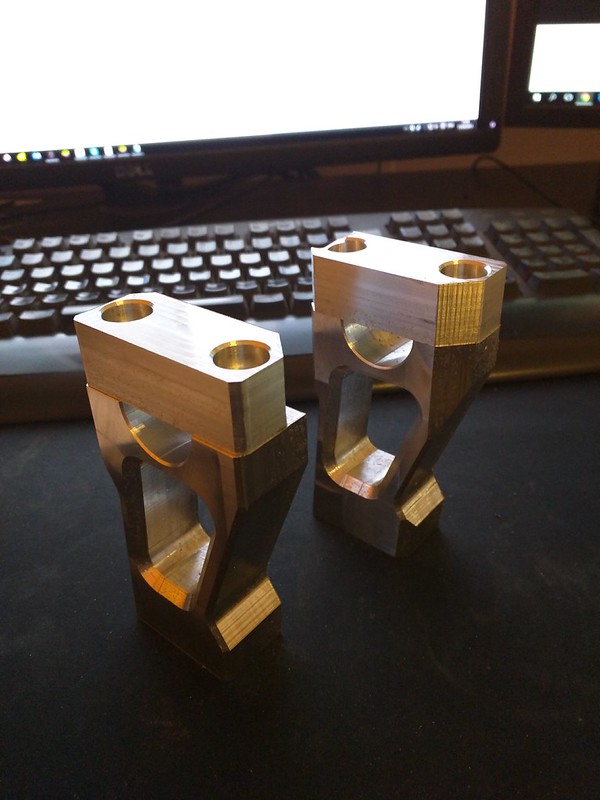

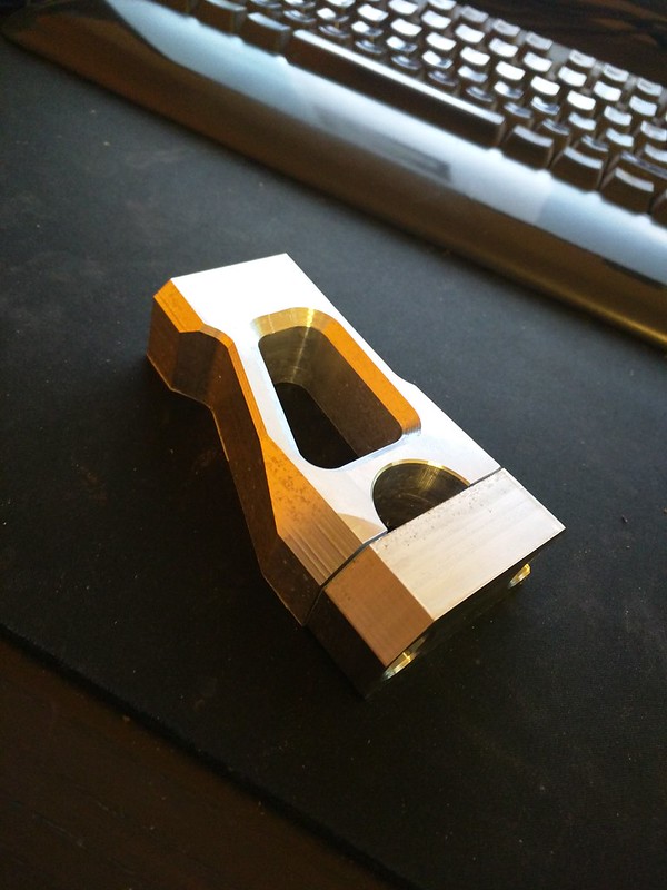

Thanks to Corie509, I now have some measurements.
We also spoke about the risers and couldnt really see the benefit that the expensive Yamaha ones added apart from perhaps a small increase in height and some forward / backwards adjustment.
I did mill some, just uploading some pics.

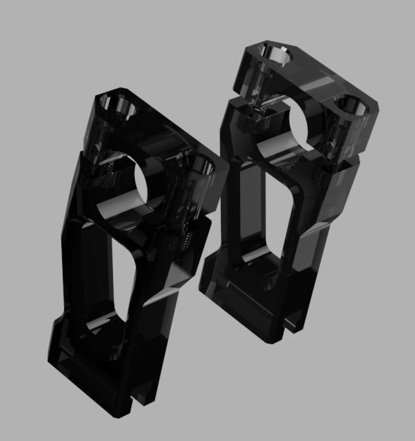

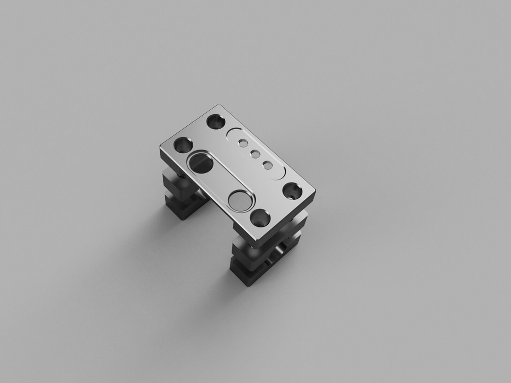

We looked at the design and we came up with a different idea and that is to keep the existing system and add in a smaller spacer below, lift the whole lot around 25mm and then have an optional top plate which will integrate into the replacement clamps.
And then the new design below:-
