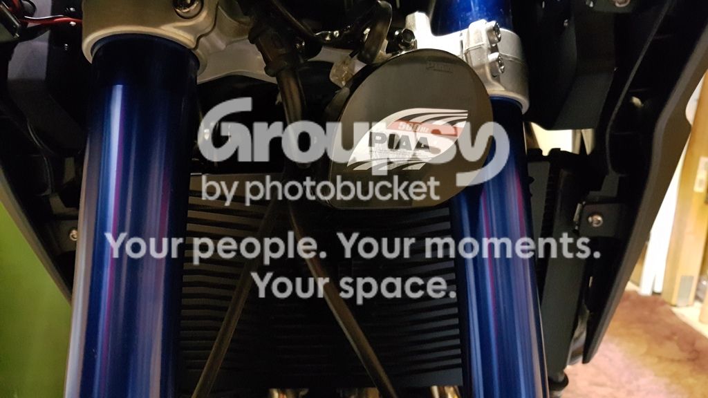

Then today the Piaa's arrived and as you can see both of them went on a treat with a couple of spacers behind. I still need to tidy up the riding but my god what a sound !
Also no relay needed just a bit of jiggery pokery with the split feed.

How did you mount them Mr Quinlan? I tried all sort of options but couldn't the two to fit.
Just behind the horns you can see the heads of 2 Allan Screws. They fit into 2 tapped holes in the lower fork brace. Those holes are for a small black bracket that supports the original horn and also a cable support for the horn. They are a real fiddle to get your hands in (mine anyway!) but if you take the original horn/bracket off you will see the RH one. You will need spacers about 25mm long to bring the horn mounting plate away from the fork brace as well.
Have to watch the threads though, after temporarily fitting them last nite, I removed the RH screw to add some locktite, that was a mistake ! The alloy of the fork brace must be real soft because I must have slightly damaged the thread getting it out and took me half an hour to get the bloody thing back in and I know I cross threaded the damn thing but it was the only way to get it in, Mind you it didn't take much effort to get the new screw in so the alloy must be like plastic ! Needless to say I didn't need the thread lock !
I'll try and get a photo from underneath with it all fitted coz I'm not taking them off again !!

Would appreciate a pic Mr Quinlan:)

Yeah looks good and sounds a lot better with both on.
Finally managed to get a couple of photos, the muddy one is from underneath, bike's been cleaned now !!
