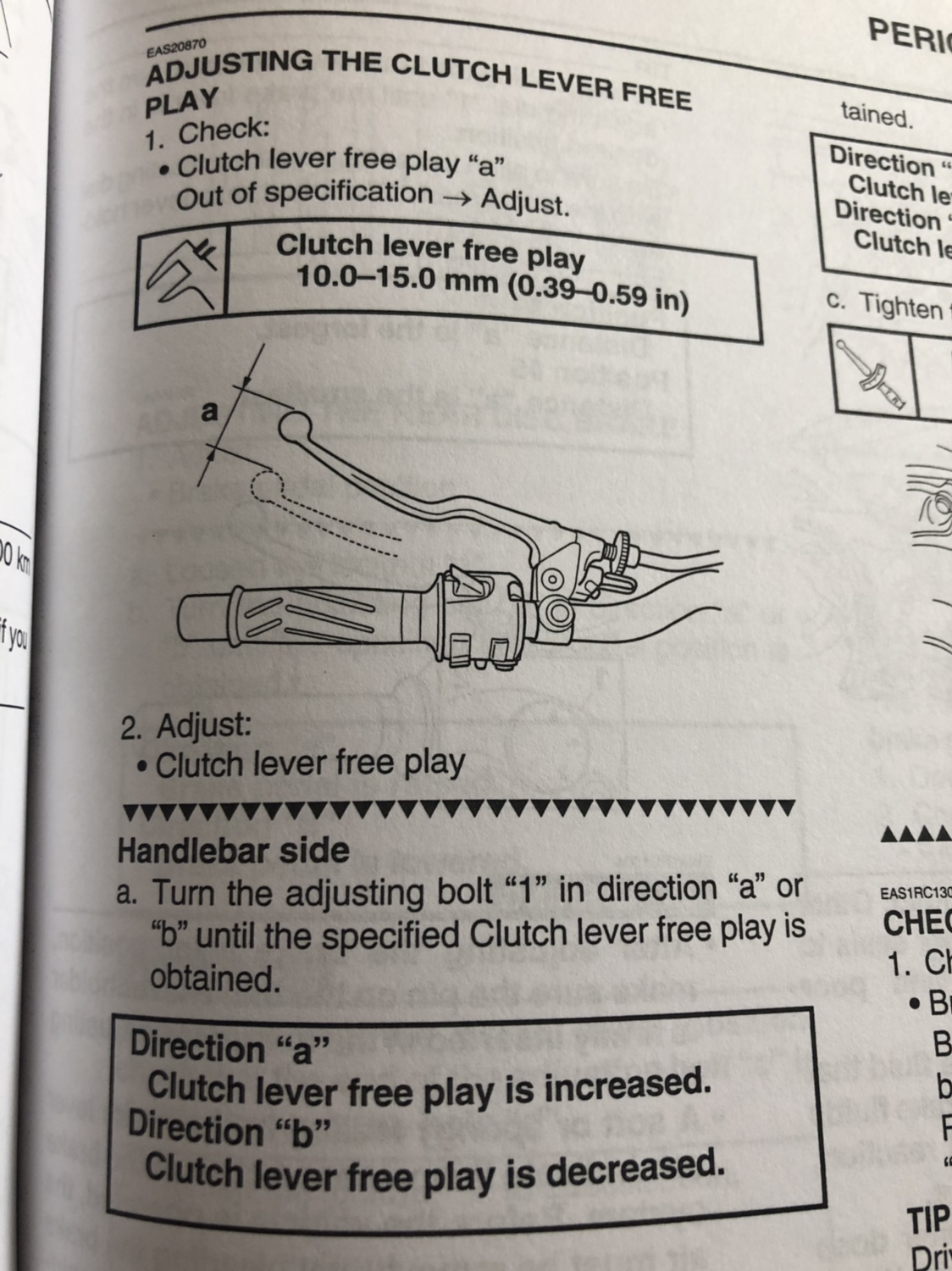

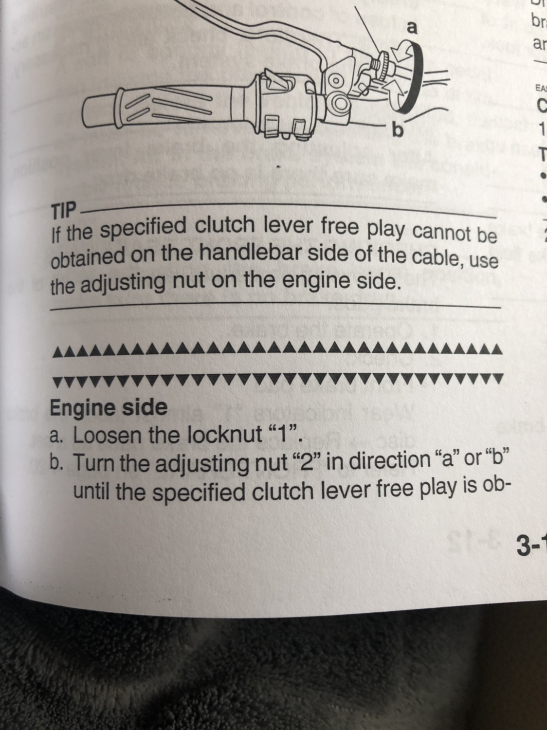

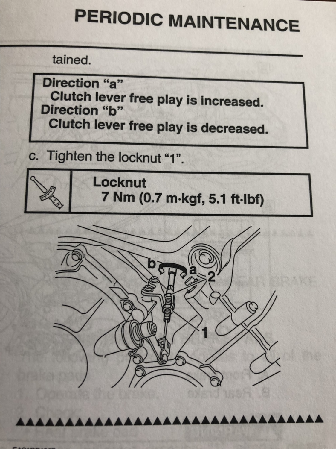

can anyone show me how to adjust the clutch cable at the engine end. `the retaining bolt I can loosen easy bit the upper nit is incased within the bracket and you cant get to it? so i cant adjust.
the cueball
There is no mention of having to remove a bracket or anything in my service manual (2016)..
Going my the diagram below, the bracket should be in the middle of the bolts, so maybe have a play around with the wire? Or loosen the lever end??
