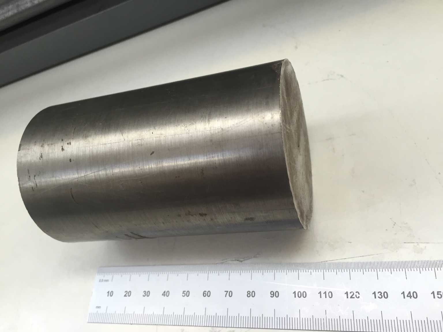

Or even just the dimensions of your version 1 as I'm a machinist so could make myself one. I have a piece of titanium bar that's 65mm diameter and 110mm long, wonder if that'll be big enough?

Titanium, 65mm dia x 110mm long

Also Ripgroove that bar stock should do you, my mk 1 baffle was matched from a solid lump and that the one i'm still using. Was out of 304 stainless though. I have a drawing somewhere which has dimensions on for machining one of these.

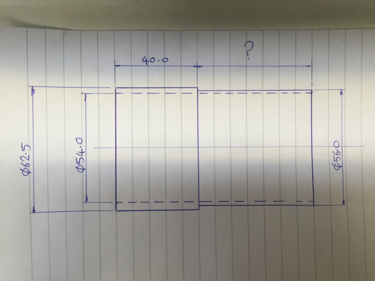

62.5mm outer flange for the exit, this is 40mm in length and 54mm ID for the inner flange with a 1mm wall thickness if i recall. haha like i say i will hunt the drawings out and PM you. Just double check your exhaust measurements as i have found out everyone's exhaust seems to be slightly different. :)
1,354
Do you recall the overall length?
Sent from my iPhone 
1,354
So basically this but with 70mm where the question mark is..
I will of course be measuring my exhaust first but it's handy to have an idea first.

Yeah thats pretty much it, i also stuck a chamfer between the step, you will find that it will but up against a weld within the exhaust exhaust which helps keep the gases from leaking past as much.
1,354
Perfect thanks man, I'll whip my exhaust off and take it in to work to measure it properly before I start cutting metal [emoji1360]
