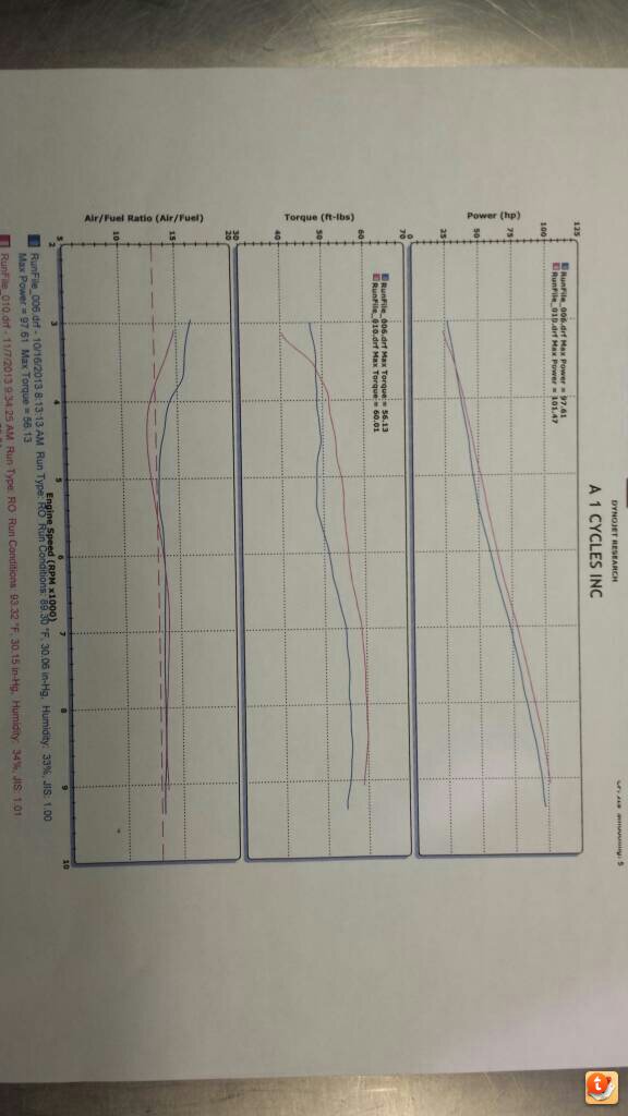

In case anyone is interested, I took my bike down to those lovely people at Pro Bike today and they did a Dyno run of my bike with the Akra, then they fitted a PCV and a map downloaded from Dynojet for the Akra (with standard airbox). No additional tweaking was performed, just used the supplied map and it's bloody marvelous!
I don't think the graphs look particularly impressive with just a couple of extra HP and Ft/Lb but jeez you can really feel the difference. It's eliminated the snatchiness and more importantly the way the power comes in lower down is very impressive.
It just flies!
Love this bike even more now.

Can you feel that on the ride or is it only visible on the dyno?
Cant say I had that problem although ive had either an EJK or ECU flash running - my bike seems to pull harder from 5-6K onwards then anything although I havent dyno'd it to confirm - probably doing that in a few weeks.
Id be interested to know what TB's feedback is on the powerdip.
Agree. This is where I picked up the most between 5-6K. Like 8 ft.lb or so.
Sent from my SAMSUNG-SGH-I337 using Tapatalk
Maybe so but u seem to be down around 10bhp and 4lbs of torque.
My bike is kicking out more than urs and uv had it tuned.

Dyno to dyno numbers vary. I know the one I use read a bit low... but all I care is the stock base map vs what I have now.
All I see on yours is 2 hp gain and 2 ft.lb of torque... Sorry... Mr. Spot
Just find it odd that urs is that low down to start with that's all...

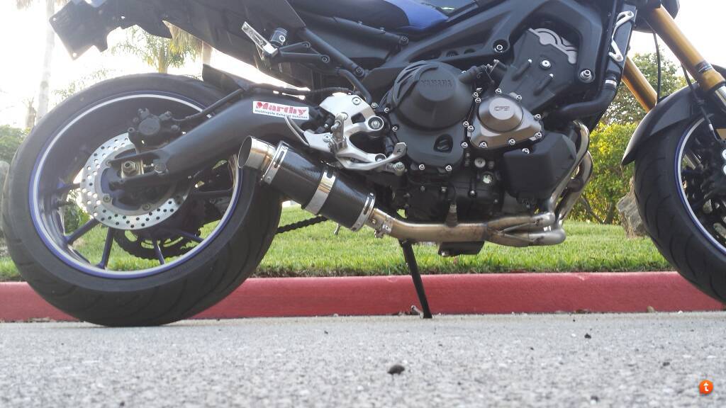

What setup are you running there marthy - one of your pipes and EJK?
sent from my Galaxy S5 via Tapatalk
Ya that was my first S shape design with Danmoto slip-on. I want to go now with my new one... delkevic ds70. CF can with a 2 3/4" outlet... sound mean!
Mate that pipe end is massive - nice!
Bet there aint any db killers in that haha.
Put up a vid so we can hear it when you get the time :)
To be honest I wasn't expecting much of an increase from just adding the PCV, as far as I was concerned the PCV was to smooth out the fueling and get rid of the snatchiness (so job done!).
It's a pity I didn't get the opportunity to get it dyno'd with the stock exhaust, I would hope that there was a decent power gain from stock.
