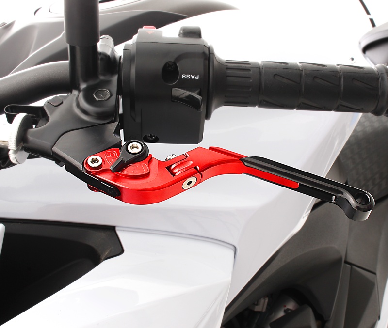

Christmas comes early in the EeeTea house. What did Santa bring? New levers!
If you read earlier, I did a clutch modification to make the whole thing smoother and lighter - and with great success. However, the reach to work the stock lever is ludicrous - okay on a short run, but ride for 1000 miles over a weekend and I was getting arm pain!
So I wrote to Santa for some adjustable levers to make things more comfortable. I sent him a link to this website: V-Trec Vario III Levers so he would know what to bring me.
Good price too £104.33 delivered for brake and clutch. (Yamaha after market levers are something like £94 EACH!). Of course, you can buy cheaper, but for life safety I like having a fully tested and certified product - These are German made, solid billet aluminium with TUV Certificate of conformity.
So here they are fitted:
Brake:
Clutch:
Verdict - very nicely made, but only suitable for three finger action on both levers. For the brake I only tend to use two fingers anyway, and the clutch is light enough now for this to be comfortable and easy to use. The clutch especially is totally cured and very very nice to use now.
If I am honest, if I were doing this again I would buy these standard V-Trec levers instead (long version) only because I think they would suit the bike's looks better (and they are half the price!) linky dinky
