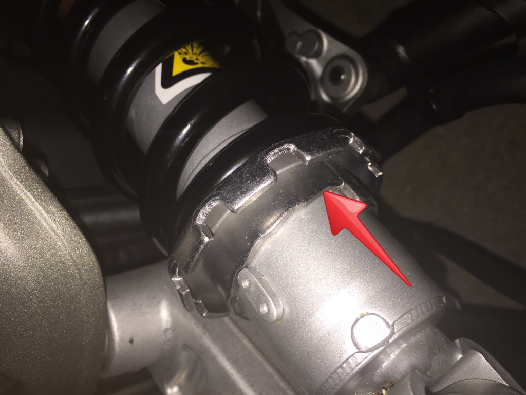

Can you make photos of front and rear adjustments, please?
Excuse the poor photos, bike is in the garage and my light is crap!

Is that right on the rear preload,it looks like its set one off max or have igot wrong as usual.
Hang on, give me a minute to clarify properly.
