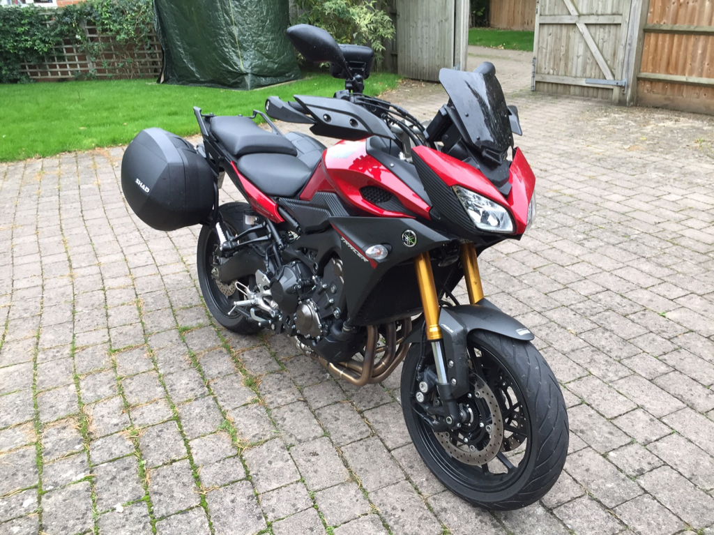

I have the Powerbronze sports screen and have never experienced a wobble at any speed, so I would say it's the screen as well.

So by changing the stock screen with powerbronze in a stock bike with shocks in stock settings, the wobble will go?
The screen is the only thing I've touched on my bike, not even had to adjust the chain yet. Well that's not strictly true I did change the brake and clutch levers for some cheap Chinese ones[emoji4]

I switched to the other screen because I couldn't stand the noise and the turbulence from the original screen. If it cured the wobble that I hadn't experienced then all the better!
