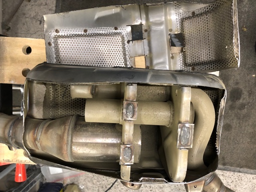

So the stock exhaust looks like this inside:
The gas flow is sent into the middle chamber, fills the area, passes into the right chamber, fills and then through a pipe underneath the short upper pipe that's visible into the left chamber and then finally into the long pipe all the way to the outlet.
Not great artistry but gives you the idea.
So in the video, he guts the lot and makes a straight through pipe. I've also seen a video where a guy cuts the right most outlet pipe, but the effect is minimal, since the short pipe is still quite a restriction and leaving the other pipes open still allows a lot of the gases to be sent the long way round.
My thinking is it will be better to block that short pipe in the right panel, then cut the section of outlet pipe, so the gases only travel into that middle section before filling the chamber and then going straight out. This isn't far off being straight through, but the fact the gas fills the central chamber allows some slowing of the gasses speed and disturbs the flow enough to reduce volume to (hopefully) a nice level.
This also has the benefit of only needing that small middle section to be opened up and a couple of cuts with a reciprocating saw to knock out the central piece. Block the small pipe off and also the section now open to the left chamber and the flow is straight through to the outlet.

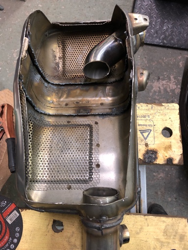

Had a bash at the exhaust yesterday.
The one I got from eBay is practically brand new - I reckon the guy selling it must have bought the bike then pretty much straight away got an aftermarket exhaust and simply flogged this to scrape a little money back. Crazy really, for the price of the stainless and the cat I bet I could flog it for scrap for more than I paid for it.
Anyway, because the Tracer exhaust has brackets on the top, where the MT09 doesn't (which is the one pictured previously) I decided to change my plan of attack. Turning the exhaust over so I was coming in from underneath it was obvious that simply opening up the end instead of trying to mess around in the mid section was going to be the best option.
Bit of angle grinder action later and I had the end open.
Got my reciprocating saw out and simply cut the exit pipe out and a large chunk of the end plate out which has opened the flow up straight from the cat into the end chamber which is then free to flow out of the outlet or bounce around to fill the other chambers a bit. It's a bit crude looking, but no way to get the entire end open without trying to remove the pipes on the right, so decided this will open the end up enough for now. You can just see the end of the cat in the opening.
Since the exit is still the same size as normal and the cat is still in place, I don't expect sound to be increased to any anti-social levels, but hoping that since the gases hit the end chamber less hindered, will give a bit more of a deeper tone. Will put it back on the bike week and do a before and after vid to see what the effect is.
If it's been a waste of time and hardly effected it at all I will open it back up and seal off the other pipes completely so it's forced to go straight out - or simply gut the whole thing for more of a straight through effect like in that guys video and see what happens (using perforated pipework and wadding). For the price I paid, it was cheap enough just for a bit of playing around just for the hell of it.

Well exhaust swapped over now, a quick dab of copper grease on the studs (might as well while its off) and the mod exhaust in its place.
I'm really happy with the outcome to be honest, which is more a happy accident as it's all guesswork, but the tone is much deeper and a slight rasp but not too loud. Put the dB meter nearby (same distance each time) and its around 10dB louder and gone from around 90-100 to 100-110. With an average around 105 that's trackday volume which is around normal aftermarket exhaust volume which is perfect.
I've used this meter before to check before track days and it reads a bit high as I thought I'd be pulled up on track but it passed fine when was tested, so in reality I reckon I'm nicely in the range. Either way it shows the increase in volume nicely.

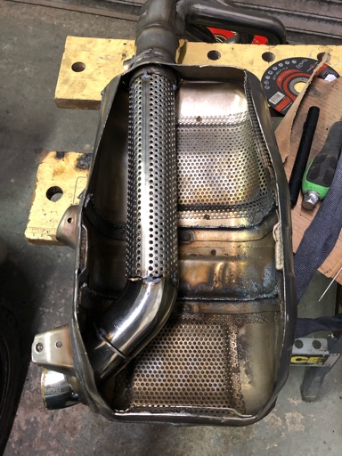

that’s my video, and that was the 2nd one I’ve done so far, on my MT09 and Tracer 900, just got another MT09 so will be doing it again.
the easiest way to do this mod is to cut the bottom off leaving the shroud mounts in place. you can do everything off the bike then.
there’s also a video of the dyno run with this mod on my 1st MT09, got over 4.5bhp increase, not bad for £30 in parts and few hours work [emoji16]
btw, it wasn’t that loud, more like an Akrapovic with the db killer in

Hi, thanks for posting, that was a good video, gave me all the info I needed before I opened it up to start attacking it (y)
I just felt it looked a bit too raucous for me, I just wanted a deeper tone but not much more volume and with an easy mod (no need to add the perforated pipe etc), but I must admit I do like the look of the wider exit pipe.
