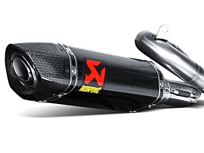

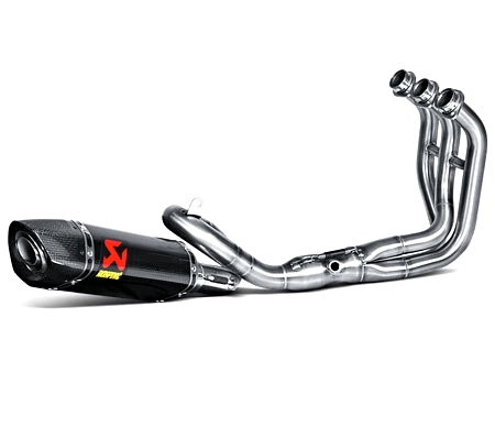

I've bought the akrapoviç race...
Flogging the Two Brothers system with the power commander (including the dyno tech map)...the PCV will come free for anyone who buys the zorst before I split them up and stick them on eBay for more
which one is this race akropovic do you mean a carbon one?
Yes this little beauty lol. The carbon one is called the Akrapovič race
Ordered it middle of last week from the good old US of A and it is due or delivery tomorrow...! Lol

Now that Akrapovič race is a nice looking system !
The higher flow rate through the tubeing loop instead of being fed into the OEM back box will be very beneficial :) :) :)
Yes it will. Beneficial to the tune of 132.6bhp...lol
