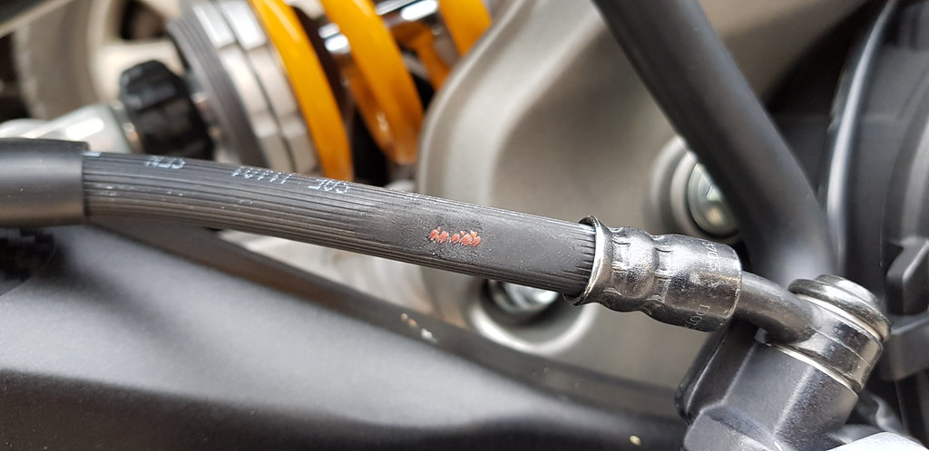

I've managed to almost wear through my rear brake hose presumably with my boot somehow so I guess now is the time to switch to braided versions.

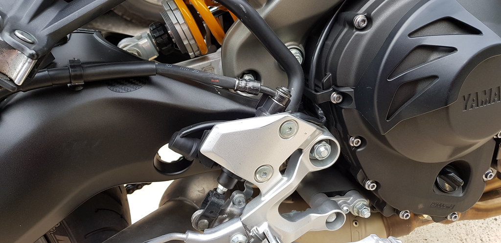

A couple of photos of the worn hose:
Not entirely sure what my boot is doing over there!
