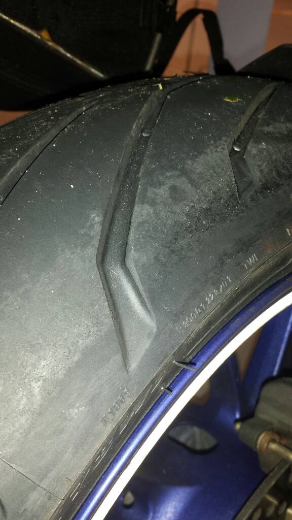

Using 30/30 cold temps here with Angle GT. +10% front & +20% rear from cold to hot if the guide line.
Once the suspension us set up right, this is about how a tire should look like.

Thanks Marthy...it looks like you have a nail in your tyre from the foto. I have checked the tyres at the local service station and the readings are identical with my hand held device....so if its all a matter of calibration then it would appear that the garage is the odd one out. I have always stuck to 36-42 and had great performance from the bike...even in scotland with all kinds of road surface and conditions. No reason to deviate from said settings...confidence in them. Will be taking readings again tomorrow when PRs are fitted....taking my pressure gauge with me and will have it out with mechanics should readings be different again.(Different garage Raceways of Fleetwood this time and not Spring court in Rochdale)..watch this space!
