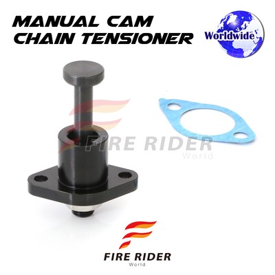

I have seen manual adjustable ones available on eBay at a fraction of the original parts might be worth having a look

I did look into the ape manual tensioner, but they dont appear to be a straight swap over

Would this ebay item work?

I bought and fitted an APE manual CCT cheaper and more reliable
