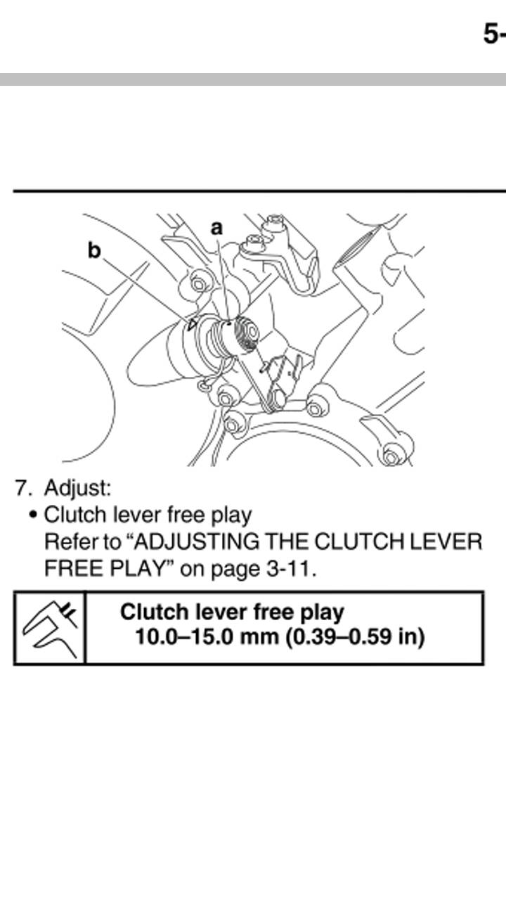

Hello all, I've just ordered some new heavy duty springs and I just wanted to ask a question about the installation of them.
Do I just need to loosen and disconnect the clutch cable from the pull lever and then the cover will pull away from the casing, or do I need to do anything else?
I can't see anything in the manual about it, or I'm just not looking hard enough.

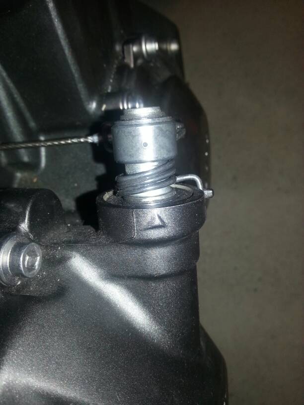

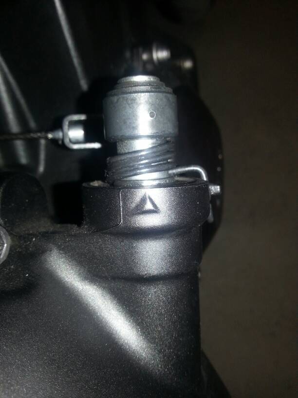

If you look on the casing and the acutator arm theres a dot and a arrow when you put the casing back on they should line up if not you will have to remove the casing and re aline them , it looks like the same set up as my r1 and when I replaced the clutch casing on it it took 2 or 3 goes to get the arm in the right position but it was relatively easy just a bit of fiddling about :cool:

Right then, I've just put it back together and when the casing sat flush, the dot and arrow lined up perfectly after the second go.
But now when reconnecting the cable I have a ridiculous amount of slack and even with adjusting at both ends it's still stupidly slack. Any ideas?

I've worked it out.
When you replace the clutch cover there is some free play in the pull lever.
You need to have the lever engaged with the clutch but NOT pulling it, if that makes sense.
I like to think of it as the resting position so when you've adjusted your cable it's in the correct position to pull the clutch plates apart when you operate the clutch lever..including your free play in the lever ofcourse.
