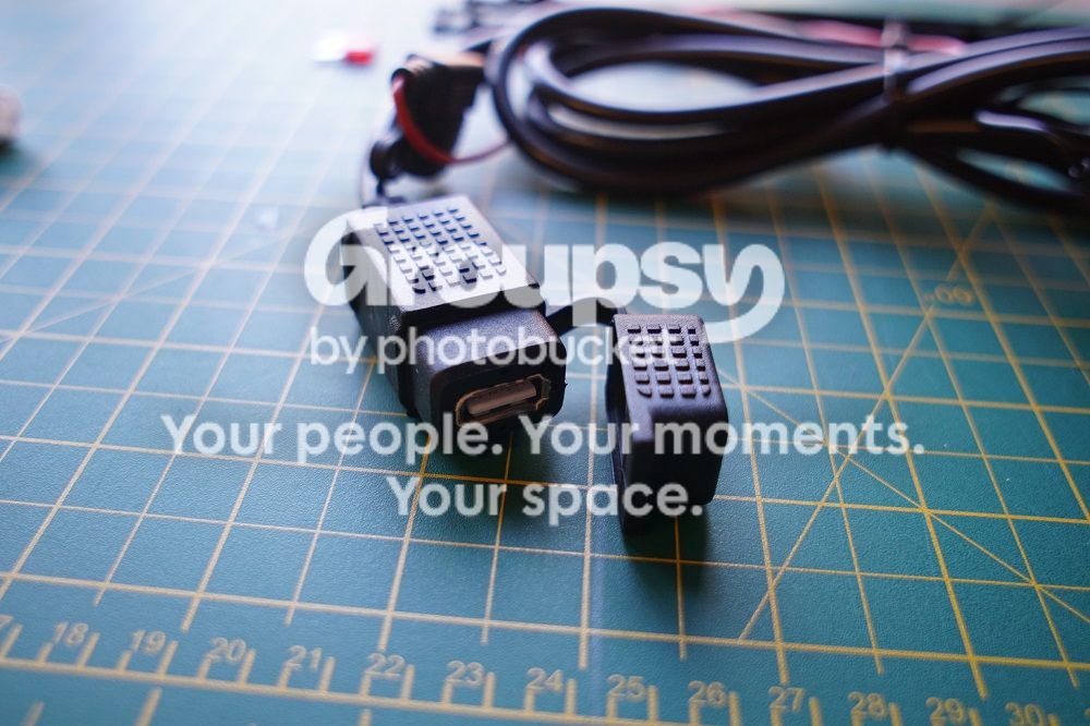

USB Socket - £8.99: New 12V/24V USB Power Supply Port Motorbike Motorcycle Mobile Charger Socket | eBay
Plug
USB Socket

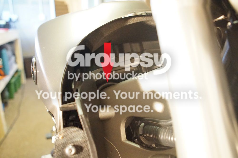

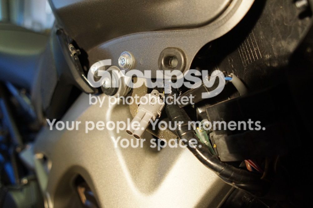

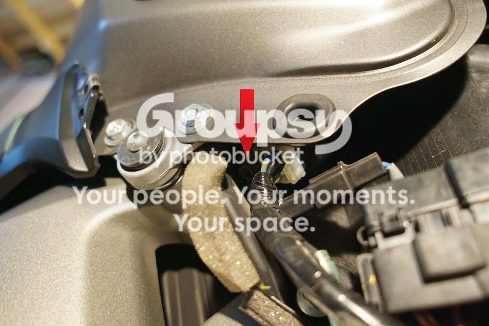

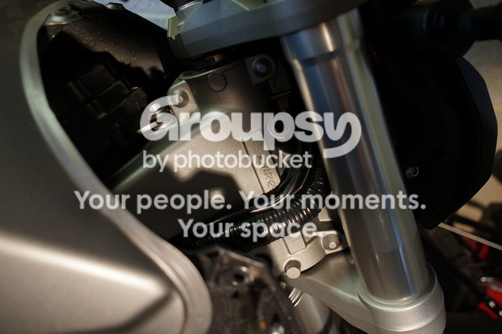

Side cover off, the plug is hidden way up inside

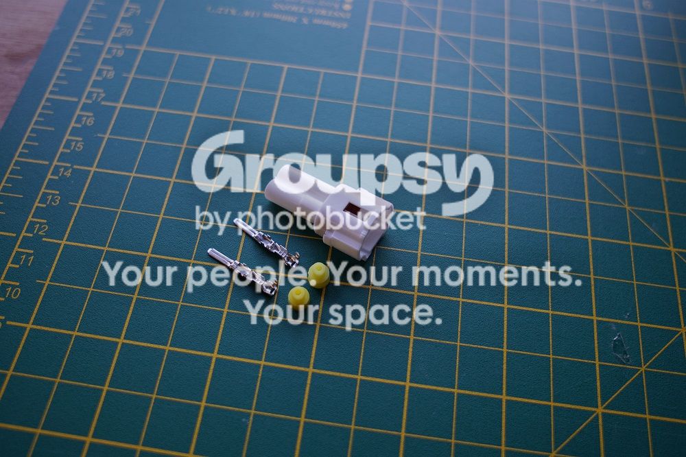

The plug actually already has a 'cover' on it which is just a female plug just like the one I bought but it has no terminals inside, so I guess you could just buy the terminals and rubber seals and use this but I found it easier to just by the whole plug.
Plug with the 'cover' off

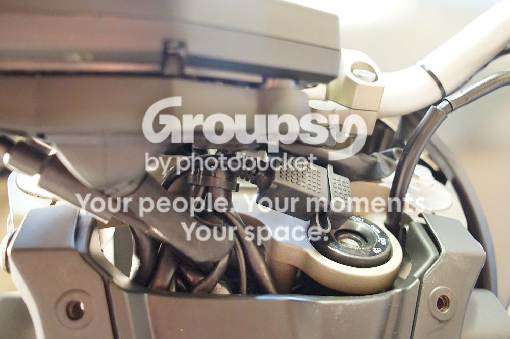

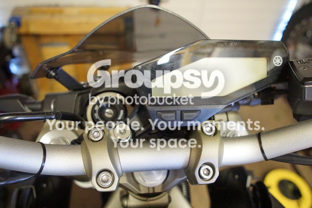

Then I chopped the USB socket I bought as I figured I wouldn't need the fuse that it came with and then started routing the cable. Here it is loosely resting under my dash:
Cable routing:

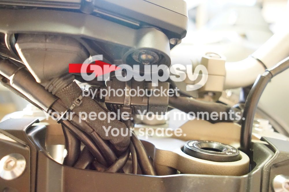

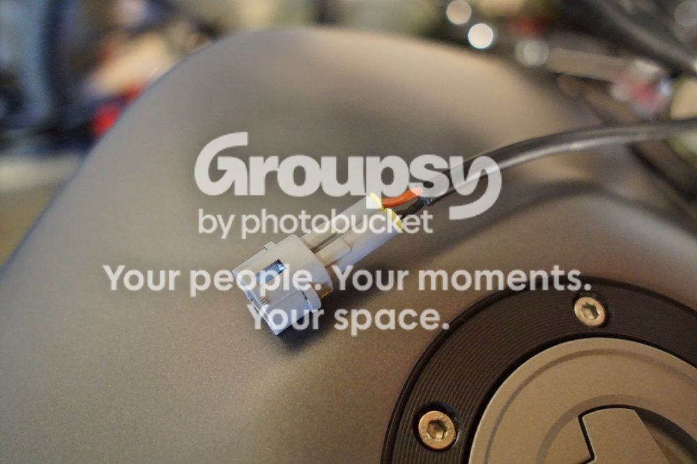

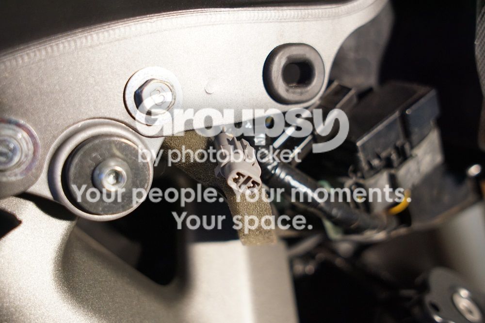

Once the cable was routed and trimmed to length I installed my new plug:

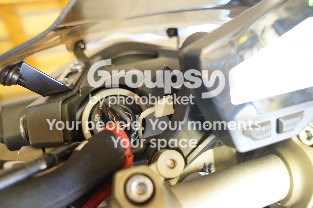

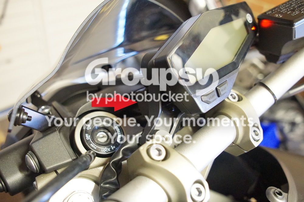

Then took my dash off and drill 2 small holes for a cable tie on the dash mounting bracket, mounted the socket under the bracket and bolted the dash back on:
Then I plugged it in and reinstalled the side cover (no pic)

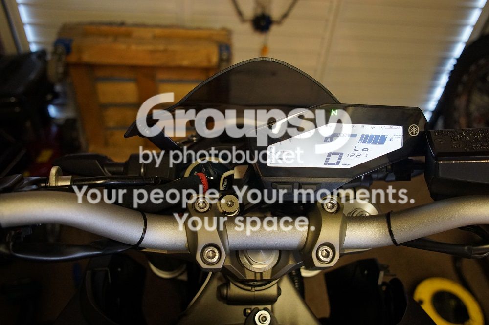

View from riding position:
View from the side:
View from riding position with a USB and my key plugged in:
View from the side with a USB and my key both plugged in:
The USB socket only has power when the ignition is on. I've also tested to see if this causes a drain on the battery at all when the ignition is off and it does not. From what I can see the bike draw 4mA from the bike with the ignition off which I guess is to keep the dash's memory alive, this figure does not change when plug/unplug the USb socket in to the bikes auxiliary power plug.
