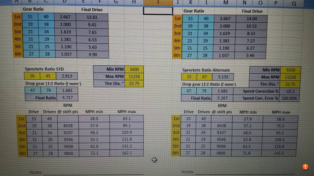

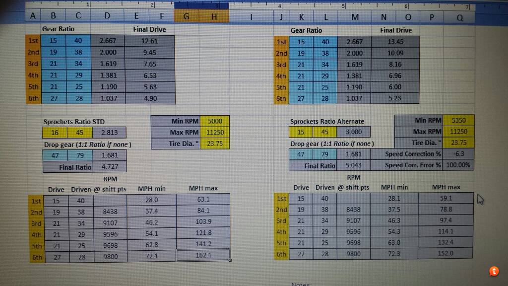

I looked into it this week. -1 front is about 350 RPM @ 70 MPH. Thinking about for when time comes...
