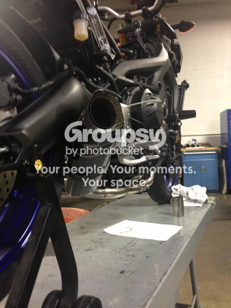

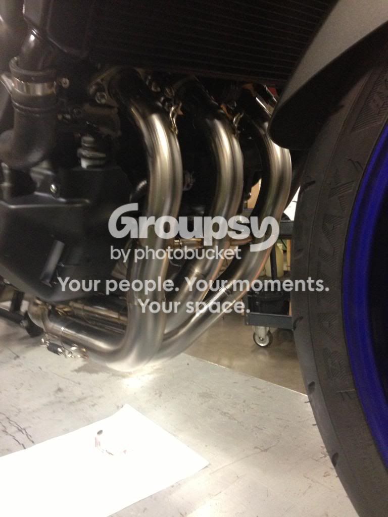

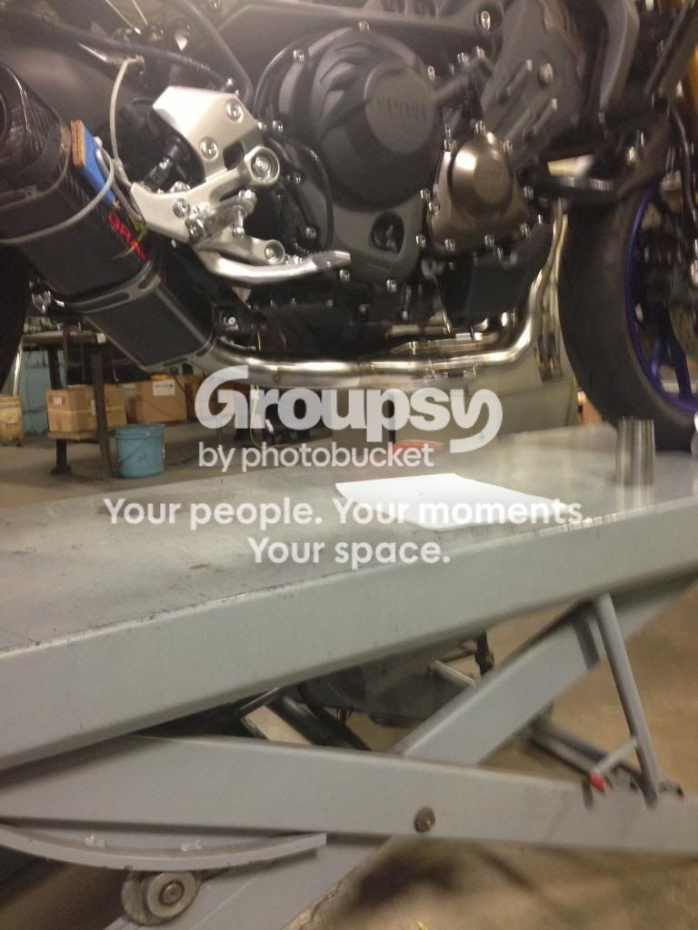

I got all my exhaust goodies. The Dino tech drop the ball on mm me this week... no dyno until Wednesday morning... I will have the exhaust ready by Wednesday evening... stay tune!

The whole exhaust is one piece... I'm waiting on a quote from my distributor. I like the way my exhaust look like but the bend tube available were kind of in between what I need to do it right. I put down a quote for 2 kits so within a week or two I should have to kits available. The fuel controller is a work in process... I should get one pretty soon. In the mean time I did collect some data with the O2 sensor connected and disconnected. Then I installed the DBKiller this morning for my ride to work. A/F seems to be in the safe zone. In ECO mode the ECU keep the A/F at a steady 14.7:1. Without the DBK the A/F hit the 15's... a bit too lean. With the DBK the A/F is in the mid to low 13's from what I could get. I will double check that on the way back home to make sure. But if this is the case my exhaust with the DBK can be use without a fuel controller and be safe for the engine. The snappy throttle on the bottom end seems a bit more manageable, even in mode A.
I'll keep you posted...
