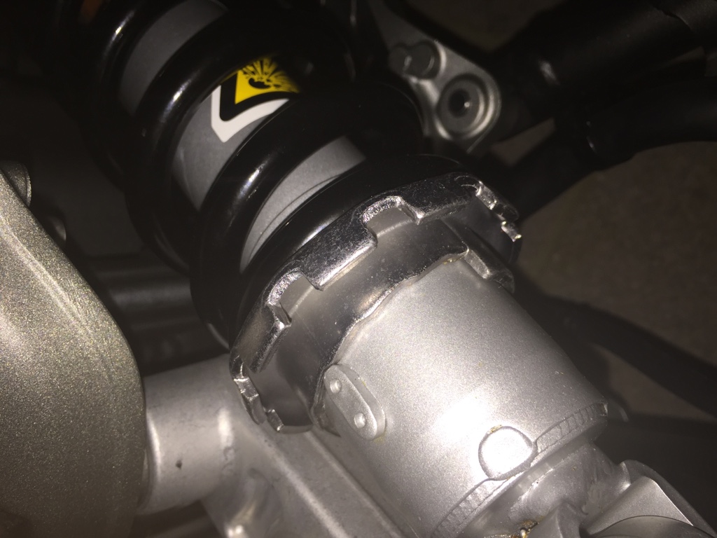

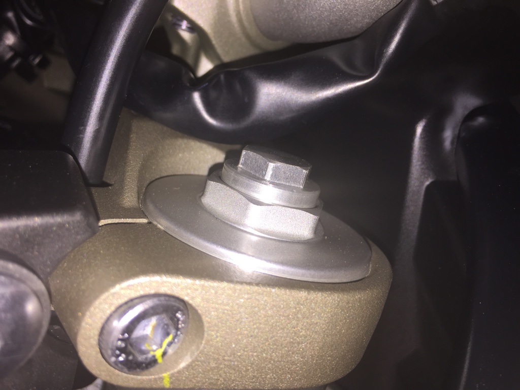

Just got back from having a static suspension setup from JHS Racing Store. Motorcycle performance parts accessories. They clearly know their stuff, I went in with full leathers and gear inc back protector and all and is what they came up with:
Rider weight (full gear): 98KG
Riding style: Fast road
Front rebound: 1/2 turn out from closed
Front preload: 2 rings showing
Rear rebound: 1/4 turn out
Rear preload: 4 off of full
Front tyre pressure: 36psi (cold)
Rear tyre pressure: 36psi (cold)
If you happen to be the same weight as me with full gear then give the above settings a try, if not and you don't live too far from the Bristol/Bath area then give them a call, £34.99 and 30mins work was all it took. FYI I actually only weigh 83KG so my gear weighed in at 15KG.
Obviously they mentioned that we're really pushing the limits here with the crappy stock equipment and they recommend some component upgrades (which we all knew anyway) so they are going to email me some quotes for various options.
The bike did feel great on the way home though so definitely an improvement. I wasn't far off with most of the settings anyway apart from the rear preload, I had this set at 1 off of full which I did because my Akra hit the floor once, so I'm a little concerned that it'll hit again at some point but if it does I'll raise hell with Yamaha as this time the suspension has been setup properly for my weight so they won't have any excuses.
Just for clarification here are some pictures:
Forks...
Rear shock...
Rear shock...
