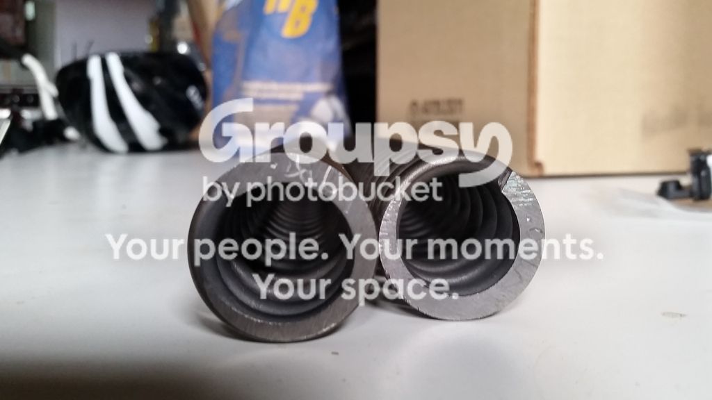

Since i am about to order this Andreani catridges from them, how to be sure that i will get right springs for my weight? I will send them note for 0.85 rate.I know that they usually send 0.78 springs (i need 0.85), does springs have some marks on it for specific rate? In case they send wrong rate?
Thanks
Kinjane
Jul 9, 2014
414
Land of Enger
If the springs have been marked, this is where you'll find it. (random web image) If you look hard enough you'll realise the .85 rating shown on both was probably written by a 5yr old
