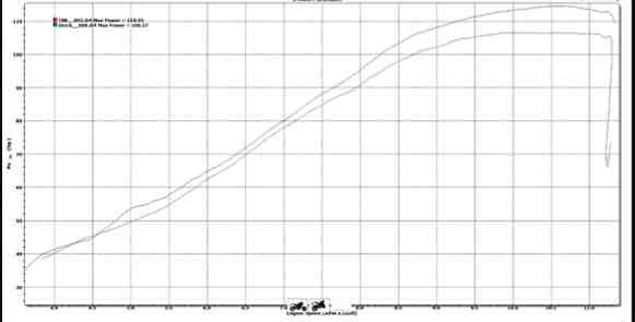

OK so my long awaited dyno finally got done.
My setup for those dont know is a TB S1R, DNA air Filter, ECU West flash with fuel maps, and PCV tuned on the dyno when this was done.
Power: 118.8HP and Torque: 66ftlb at Dynotime Wangara - Russ said his dyno generally produces middle of the range numbers as compared to other dynos in the area. As expected, I didnt have major HP or torque gains when I had it tuned and dynoed as the ECU flash already contained maps - I mainly wanted the PCV to provide a constant AFR level at the 4-6K mark which this has done well - weather is crappy over here at the moment so havent been able to get a good 'bum on seat' test done yet!
