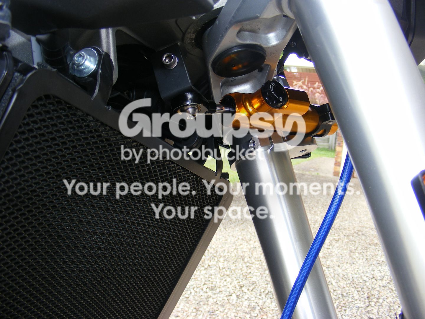

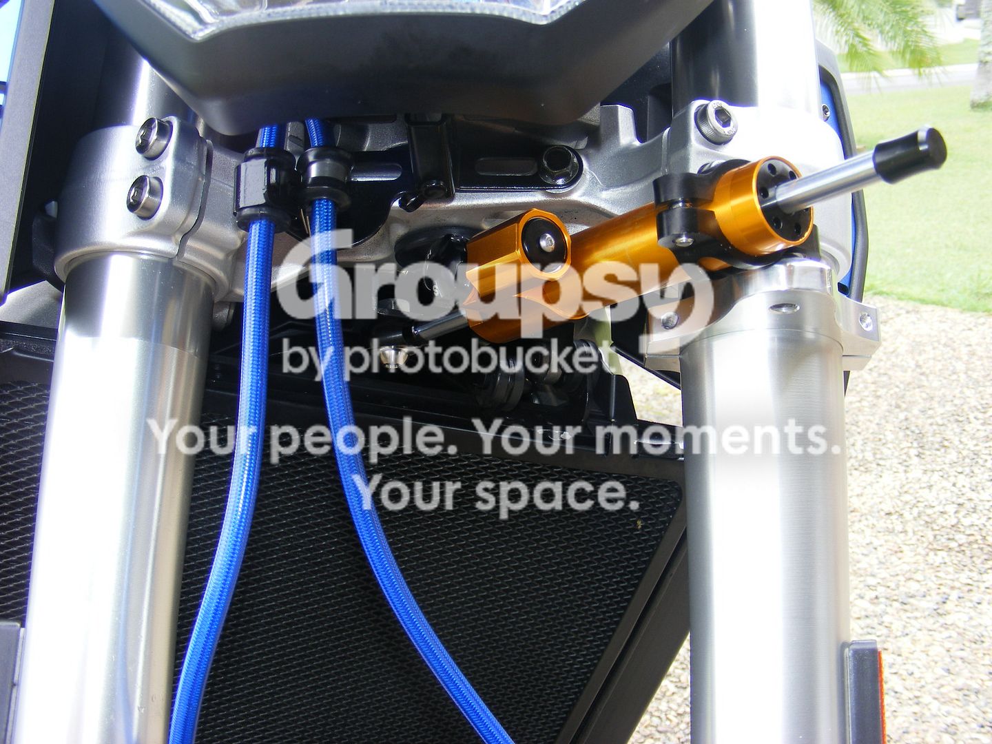

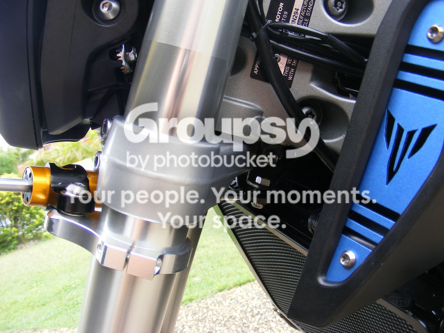

Not sure if that clamp will work as you need the shock bolt hole as out from the shock centre point as you can get it so you get the leverage.
Ah OK, do you know what yours measures here:
Sent from my iPhone

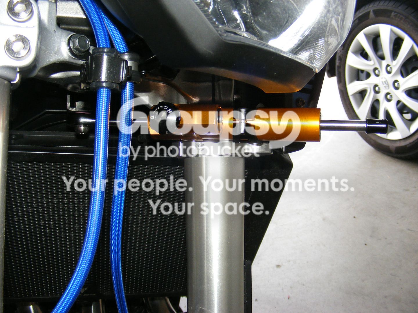

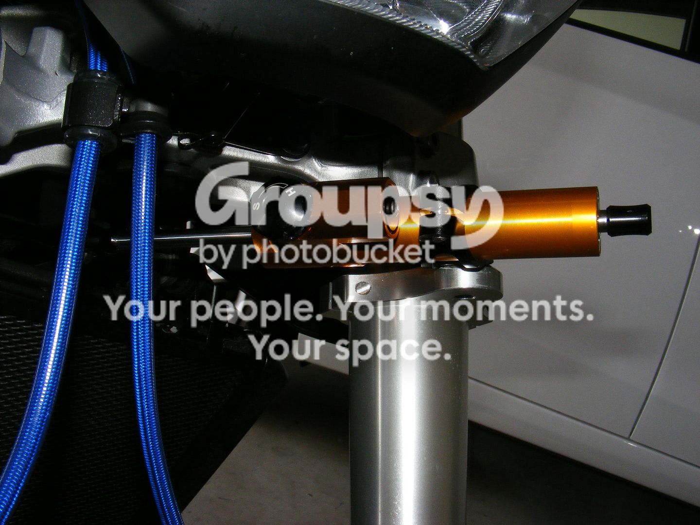

RipGroove 17mm between the arrows from the front of the fork leg to hole centre which works fine, if you going to make your own I would make it 22mm to give the damper slightly more clearance at full left lock.
Full left
Full right.

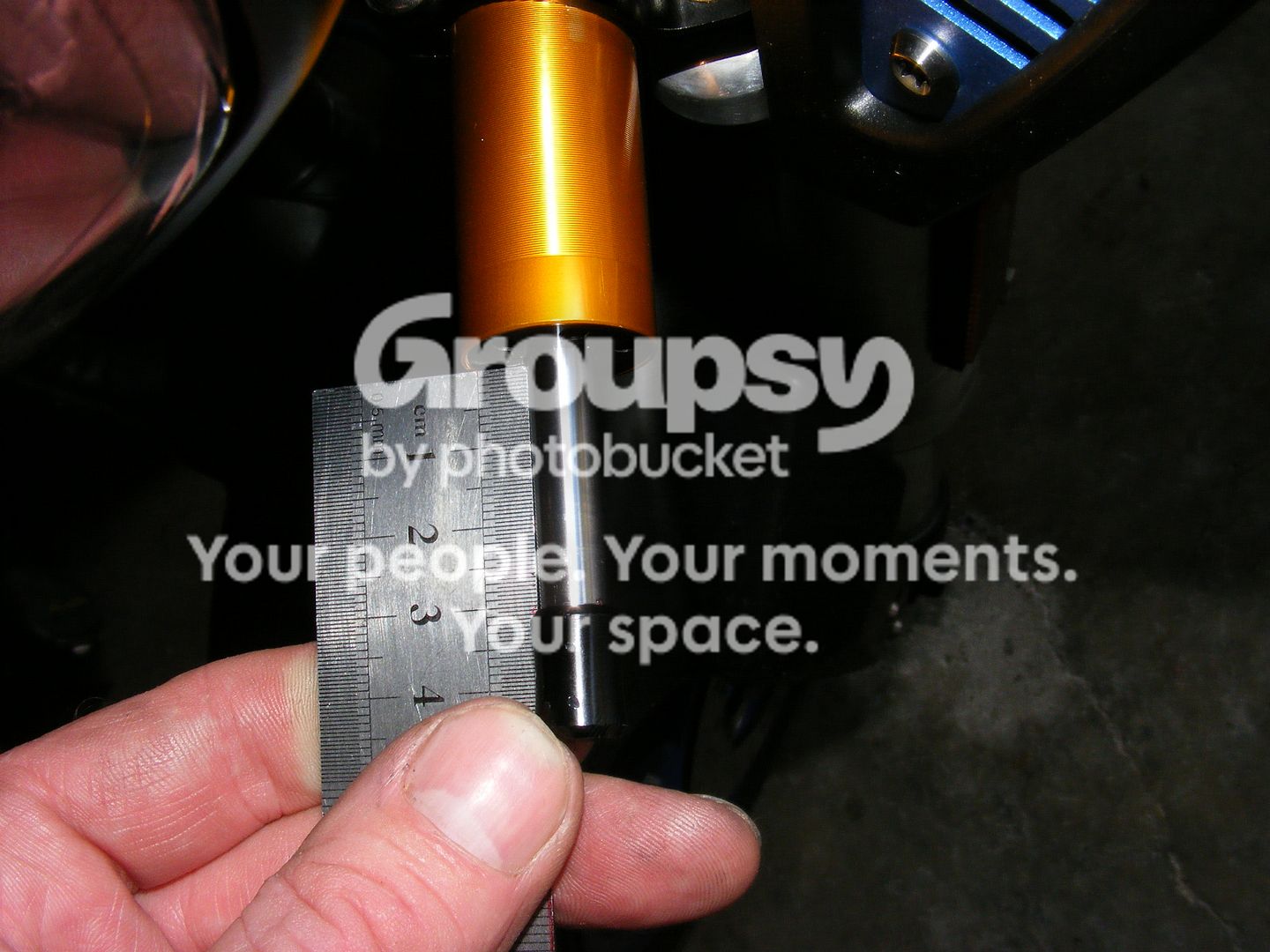

Shock travel
Excellent, thanks :)
Full left
Full right.
Shock travel
Kev,
just a couple of questions regarding the damper bracket.
You say that 22mm would be better than the 17mm to allow for more movement on the L/H side.
Is there enough room on the bracket to weld the original hole up and then re-drill to nearer 22mm ?
Also rather than filing the fork bracket down to accommodate the steering damper bracket,
would it not be possible to use a spacer therefore lifting the damper up away from the fork bracket ?
Just a couple of thoughts ive had while waiting for them to arrive.
Keep up your good work and enjoy your summer.
marksim
Nov 15, 2014
235
YORK
1/ There is enough room on the bracket to weld the hole up & move it outwards but would not go to those extremes just for the extra few mm.
2/ No room for a spacer, the fork bracket is as low as it can go before the fork leg reduces in size, it is 15mm below the triple clamp & this just allows for the damper to clear the triple clamp on full lock left. I will take some photo's tonight for you showing the clearances, at work already 7am here in Oz.

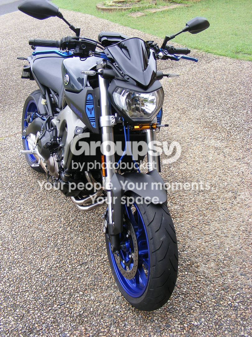

I must admit after riding with the steering damper for a week I no logger have any head shake under full throttle applications, for such a cheap mod I am really happy with the results, my final setting is +5 hard, the damper can be adjusted from zero = soft to +25 hard, anything over +20 it feels like the steering head bearings have seized up & makes the bike unrideable, +3 to +5 is just about right for me.

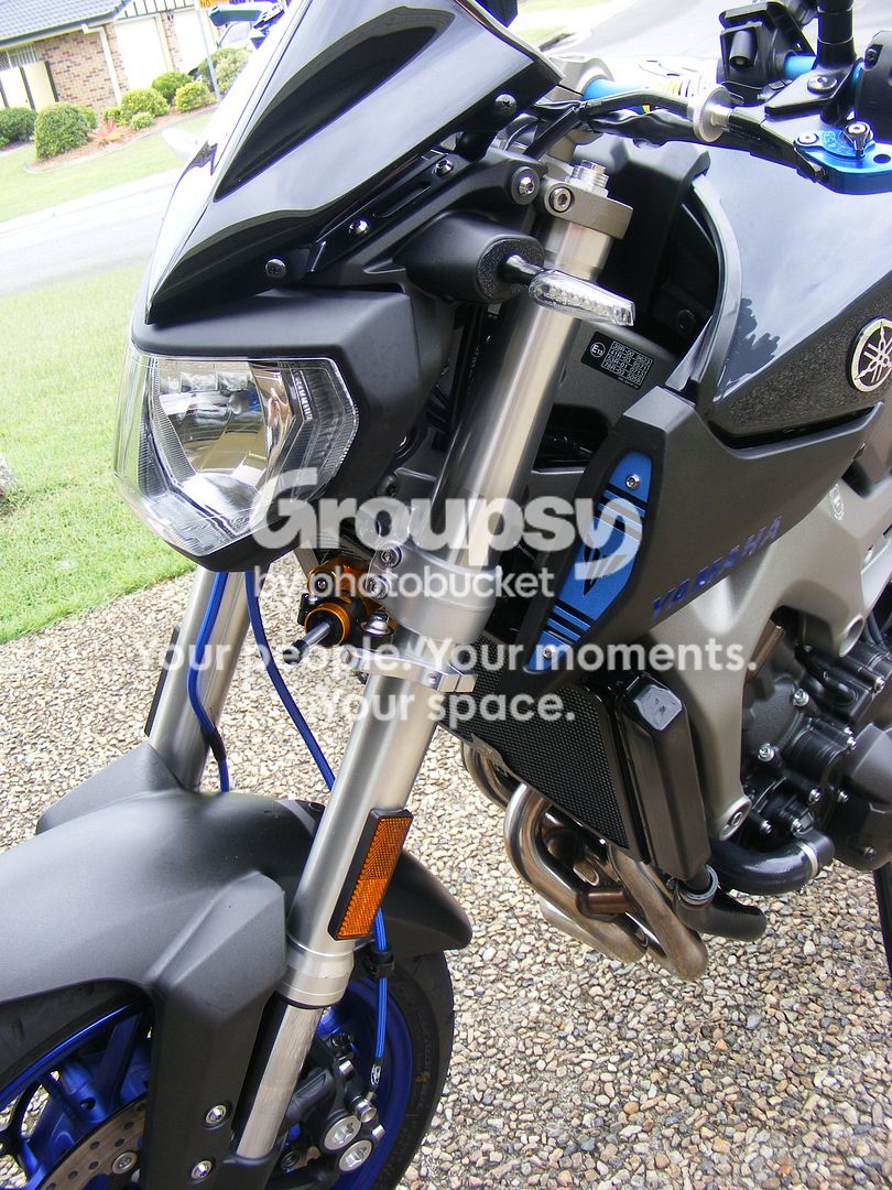

Hi Kev,
Did you have to re-locate the horn? Here in US, FZ-09 horn will be right in the way of the steering dumper. So I wonder if you have done anything or MT-09 have horn positioned some other place...
