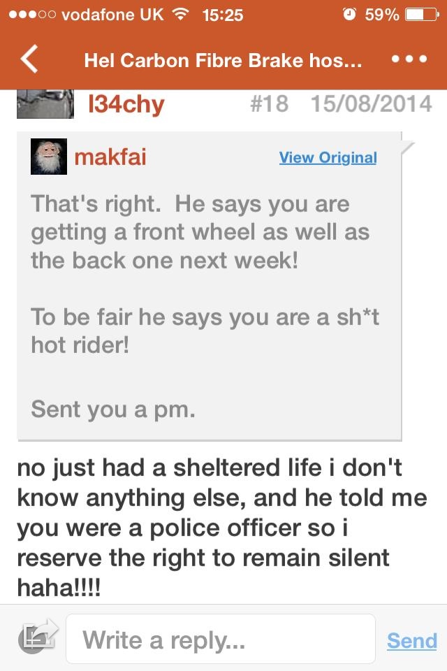

If you feel you have established that then your detective ability has let you down. :p
I am not a member of a police force; I have never been a police motorcyclist; but I do confess to, before retirement, having been a motorcycling instructor but at advanced level - never taught learners.
Hope that satisfies your curiosity.:rolleyes:
Do I write as a biking instructor? What part of the police did you believe I was in?
Probably due to this post maybe?
